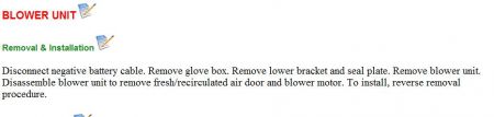

I have a mouse dropping smell when I turn on the heater. could there be a mouse nest in the heating unit? And if so how do I find the box or space that would be harboring this? Behind the glovebox? or elsewhere? and where would I find a diagram that will allow me to find and disassemble the unit?

Hi there,
I will look this up, i don't have access to Mitchell 1 just now but when i get it back i will post some information for you, and i will be off to work soon so it will be my time this evening.

https://images.2carpros.com/forum/automotive_pictures/61395_Noname_98.jpg
