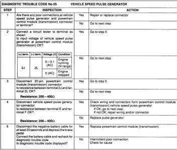

Hi, the hold light on my 94 Mazda Miata is flashing. I looked it up and it is flashing code 55 which is "speed input sensor". I would like to know where exactly that sensor is located and if there is a procedure for checking the sensor to confirm that it is faulty. thanks

hello and thanks for donating follow the steps below to troubleshoot code 55. your vehicle's speed sensor is attached to the speedometer assembly.
https://images.2carpros.com/forum/automotive_pictures/261618_Noname_2087.jpg
