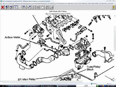

Where is the intake air temperature sensor located on a 1990 mazda miata?

It's built in to the airflow meter.
