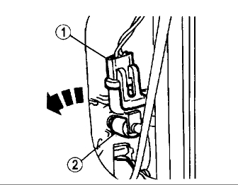

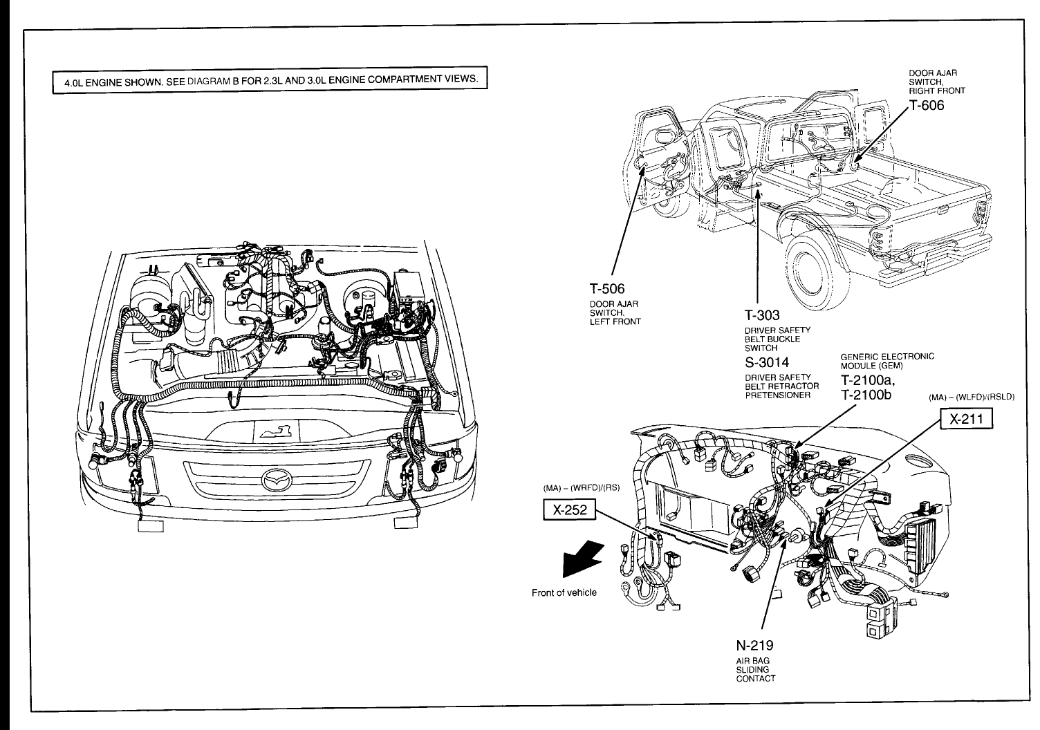

Dome light in my truck was not working. I then change the bulb an found that it was at fault. Problem now is that i cannot seem to get it off and i cannot locate a switch to turn it off. I had to take out the bulb. Where is this switch?
Feb 18, 2018 at 1:48 AM
STEVE W.
  • 15,379 POSTS
It is inside the door itself. You remove the door trim panel and it will be attached at the rear edge and have a two wire connection. Check out the diagrams (Below). Please let us know if you need anything else to get the problem fixed.
