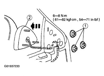

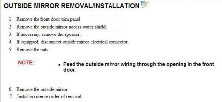

how to put on a driver mirror. I see 3 crews on th emirror but don't know how to put the mirror on. Do i screw it from the inside or outside?

https://images.2carpros.com/forum/automotive_pictures/261618_Noname_1822.jpg
https://images.2carpros.com/forum/automotive_pictures/261618_Graphic_368.jpg
