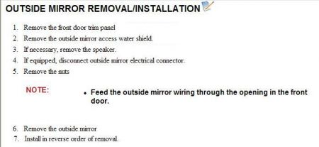

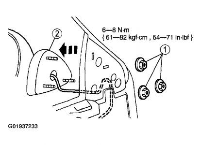

how to put on a driver mirror. I see 3 crews on th emirror but don't know how to put the mirror on. Do i screw it from the inside or outside?
