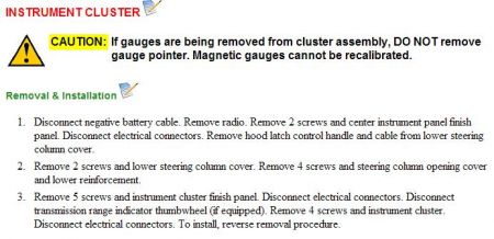

I must replace my instrument cluster because I broke the lens badly. (Don't ask.) Obtaining a used cluster shouldn't be a problem, but I have two questions.
Firstly, if I find one that has a lower odometer reading than the one I presently have, is it possible to advance the odometer so that it matches my current odometer?
Secondly, I know how to remove the cluster, unhook the wiring harnesses, etc, but I don't know how to remove and reattach the shifter cable. Does it detach at the instrument cluster end or at the shifter end? How is it detached?
Thanks.

Hello Thanks for the donation You will have to get your vehicle serviced and have the replacement odometer calibrated to your vehicle. Below is the proper replacement procedures for your vehicle's instrument cluster..
https://images.2carpros.com/forum/automotive_pictures/261618_Noname_394.jpg
If you need further assistance just let me know.. Thanks for using 2CarPros.com!
