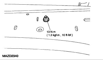

how do you change the fuel filter on this type of truck?

Relieve the system pressure. See FUEL PRESSURE RELIEF. Disconnect the push connect and hairpin clip fittings. See PUSH CONNECT FITTINGS or See HAIRPIN CLIP FITTINGS.
https://images.2carpros.com/forum/automotive_pictures/12900_f1_7.gif
Remove the fuel filter from the bracket.
https://images.2carpros.com/forum/automotive_pictures/12900_f2_6.gif
If necessary, remove the nut and the bracket. Install in reverse order of removal.
