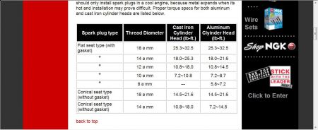

How much torque to apply when new spark plugs are installed. Thank you.
Apr 8, 2009 at 9:51 PM
  • 75,992 POSTS
See below
https://images.2carpros.com/forum/automotive_pictures/12900_sp_1.jpg
