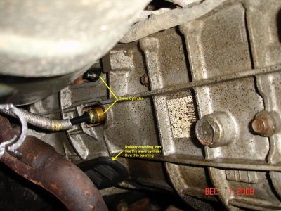

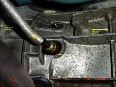

Hi Mark, After removing a small rubber covering directly underneath the gear box, I can see the slave cylinder inside and on the rubber boot, it is all wet and looks to be leaking. I stuck a screw drive thru the opening and touched the rubber boot and it was wet with fluid. So you're correct that the boot is leaking. What is the recommended step and do I replace the whole slave cylinder? If so, how do I get the slave cylinder out? It looks like I have to pull the gear box covering off, is this possible to do or do I need to take this to an auto shop? I am a little technical and is this something I can do myself ? I have changed timing-belt and water pump before, but nothing clutch related. I have also attached 2 pictures as visual guide to the gear box that I have, you probably know what it looks like already. Thanks again for your help. Lon

OK, well i was unaware that it was an internal slave as that model here,(in Australia) has an external slave. I will send details on removal tonight my time and you can decide if you are up to doing this job, talk soon,

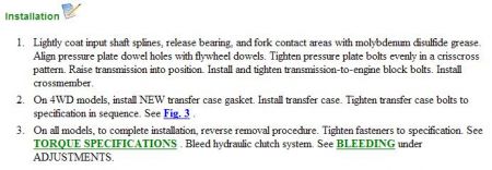

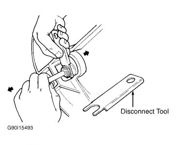

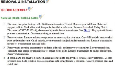

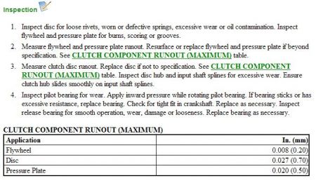

Hi there, Here is the transmission removal info, there is a special tool for the clutch hydraulic line disconnect and you will need a clutch aligning tool for the clutch assembly installation.. Mark (mhpautos)
