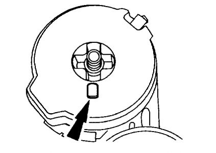

Hello -- Alright - good on you.......it will be fun........... Here you go........ I have provided info on first the belt removal then the tensioner. Good luck! REMOVAL AND INSTALLATION Note: Conditions requiring replacement of the drive belt are excessive cracking or wear, severe glazing or frayed cords. Replace drive belts exhibiting any of these conditions. Minor cracks in the back of the drive belt are considered acceptable.
https://images.2carpros.com/forum/automotive_pictures/248015_1_16.gif
Remove the drive belt. (1) Rotate the drive belt tensioner. (2) Remove the drive belt.
https://images.2carpros.com/forum/automotive_pictures/248015_2_20.gif
Install in the reverse order of removal. BELT TENSIONER REMOVAL AND INSTALLATION Remove the drive belt; refer to Drive Belt Removal/Installation. Remove the drive belt tensioner bolt and the drive belt tensioner. Install in the reverse order of removal.
https://images.2carpros.com/forum/automotive_pictures/248015_3_16.gif
https://images.2carpros.com/forum/automotive_pictures/248015_4_8.jpg
Note the location of the alignment tab. Position the drive belt tensioner and install the bolt. Tighten torque: 24 - 31 Nm (18 - 22 ft. lbs.)

So let me ask this. This looks like it referes to just the outer part of the assembly. What I had orders was a complete assembly. Do you know for this vehicle if this *is* the whole assembly or if this is just the front peice shown here? Is it more involved to do a "full assembly" part or is this it/all a mechanic would do? Thanks again.
Nov 5, 2008 at 12:02 PM
IMPALASS
  • 3,112 POSTS
Hello -- sorry you are having problems with your vehicle. Yes, it does appear that this is only the pulley wheel. I looked through two different tech manuals to give you a better diagram/pic but neither have what I am looking for. It is kind of crazy. I can give you a pic of the inside timing gear but there is no pic of the tensioner. I also looked at every truck and for some reason only NASSA I guess has access to your particular tensioner. Does this pic look more like it?
https://images.2carpros.com/forum/automotive_pictures/248015_dyc305233003_1.jpg
Take a look at the truck. It should be held on with 2 maybe at the most 3 bolts. The big thing is make sure whatever hole you remove the bolts, put them in the same one due to length. I do believe you will be able to do this. Look at the new part, see how it is orientated to the one on the engine. That will give you an idea on what you are working with. As for your other question, my suggestion is yes, change the entire assembly. You have 120K on the entire assembly so that only makes sense. I have never just changed just the pulley wheel. The option is there obviously in case you burn up a bearing in it etc. Let me know if you need more help. Send us a pic also if you need to.

Tensioner in. Worked like a charm. Thanks!
