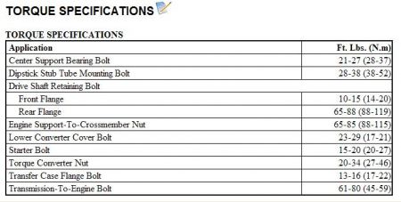

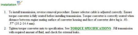

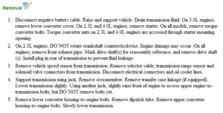

1996 Mazda b3000 transmission removal
1996 MAZDA B3000
130,000 MILES • 6 CYL • 2WD • AUTOMATIC
JM6632
What I've done so far: Removed all bell housing bolts.
Disconnected tranny lines to radiator. Removed Speedometer cable. Removed Drive shaft. Removed all electrical plugs to tranny. Removed outer bolts on rear cross member but not tranny bolts yet. Pull dip stick out but having a hard time pulling fill tube. (suggestions?)
Something else seems to be holding it. I cant get it to slide back at all. Also looks like i might have to remove front cross member that has suspension arms attached
to it.(pitman arms?) And Exhaust might have to be removed. Maybe even motor mounts? Also do I need to remove torque converter bolts?
Jul 12, 2009 at 3:03 AM
MHPAUTOS
  • 31,937 POSTS
HI there, Thank you for the donation, You are on the right path with what you are doing, the dip stick tube will pull out it is tight, the torque converter must be unbolted and you can remove the exhaust to give your self extra working room, see text for R&R procedures & torques. Mark (Mhpautos)
