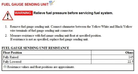

My gas gauge needle not working

follow steps below to test the fuel gauge sending unit..
https://images.2carpros.com/forum/automotive_pictures/261618_Noname_1917.jpg
