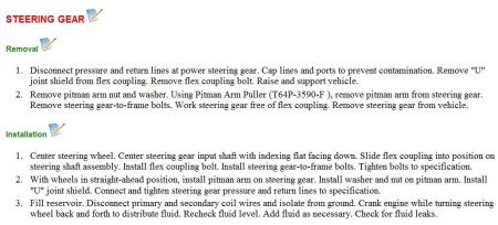

how do i remove the steering rack

https://images.2carpros.com/forum/automotive_pictures/261618_Noname_2770.jpg
