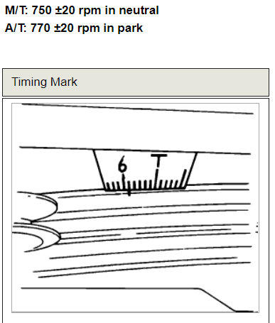

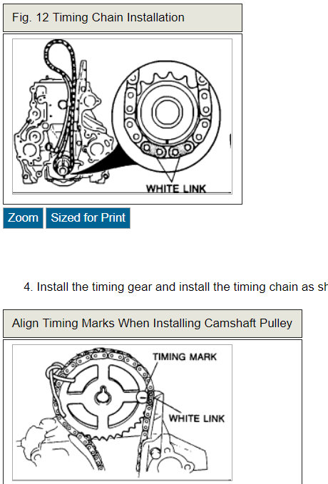

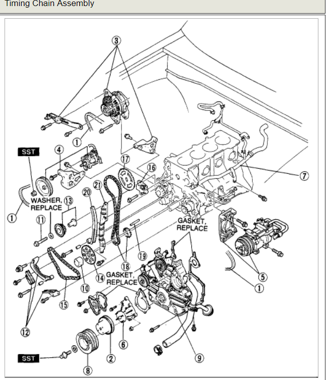

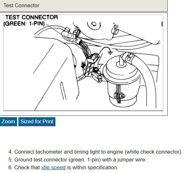

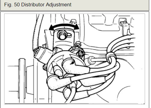

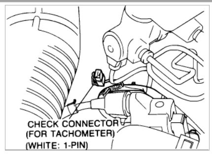

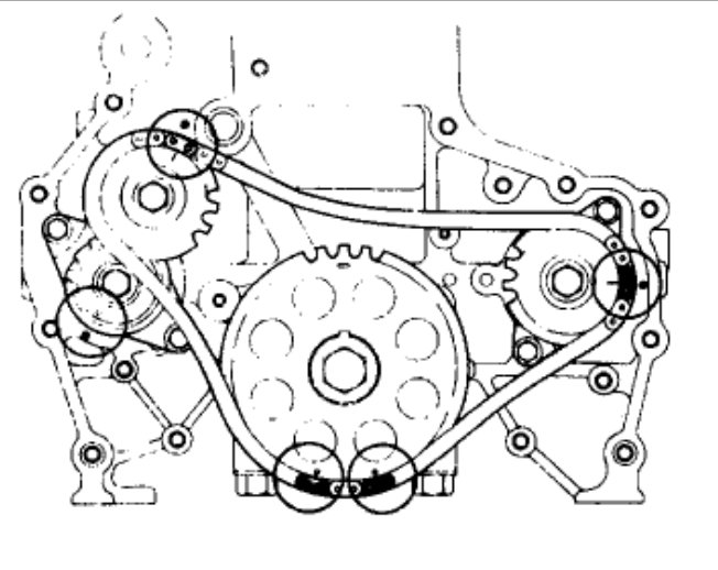

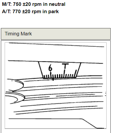

i am needing the timing marks for my 2.6l 4x4
Sep 15, 2010 at 1:01 PM
  • 75,992 POSTS
Here are diagrams to help you see how to time the engine both ignition and timing and balance shaft chains.
