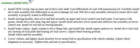

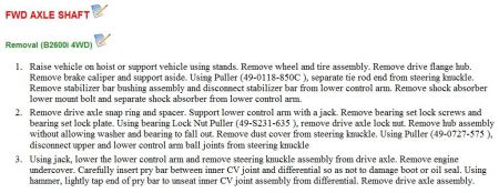

What are the steps for removing and replaceing the front half shafts on my 1992 4x4 B2600I

https://images.2carpros.com/forum/automotive_pictures/261618_Noname_2769.jpg
https://images.2carpros.com/forum/automotive_pictures/261618_Noname2_901.jpg
