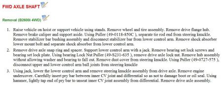

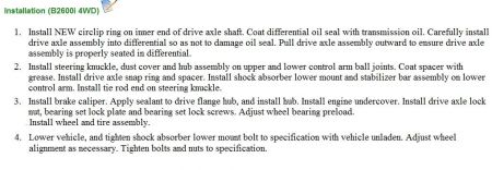

Need to know what steps need to be taken. To remove and replace the front half shafts on my truck.
Sunday, March 28th, 2010 AT 2:47 PM

Tuesday, October 12th, 2010 AT 12:27 AM
