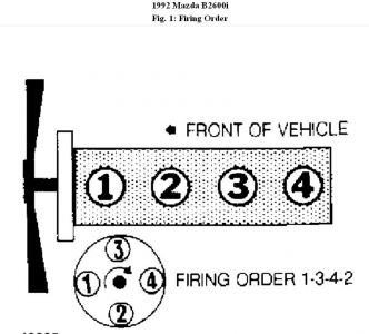

it is a 2.6L what is the firing oder and do i start with # 1 @ tdc of the compression stroke , and what is the best way to check the maf, map
Oct 31, 2010 at 7:48 AM
KHLOW2008
  • 41,814 POSTS
Firing order is 1-3-4-2.
https://images.2carpros.com/forum/automotive_pictures/192750_FiringOrder92B2600Fig01_1.jpg
Yes, you start with # 1 on compression stroke at TDC, ie cylinder # 4 valve overlapping. Without any trouble codes, the only way to test the MAF or MAP is with the aid of scan tools. Try cleaning the MAF with MAF cleaning spray and see if it helps. Sometimes when air flow sensors are dirty, they would not work correctly and does ot trigger any trouble codes.
