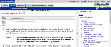

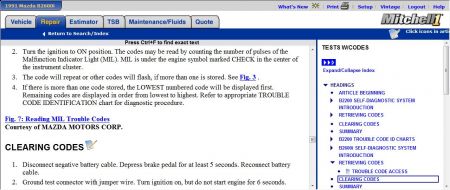

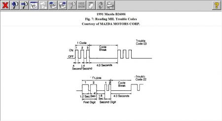

Lets try to check for code/s-Do below
https://images.2carpros.com/forum/automotive_pictures/12900_b26001_1.jpg
https://images.2carpros.com/forum/automotive_pictures/12900_b26002_1.jpg
https://images.2carpros.com/forum/automotive_pictures/12900_b26003_1.jpg
