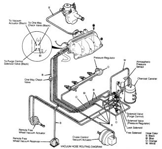

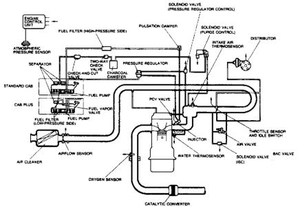

this my first truck and i have been looking for the vacuum diagram and have no luck so i was wondering if you guys had one it is efi
