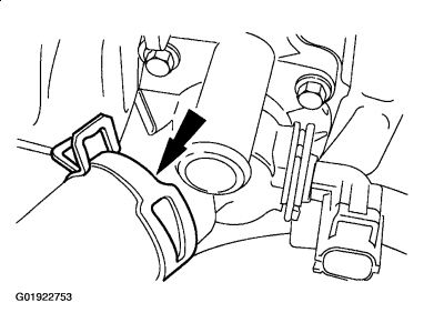

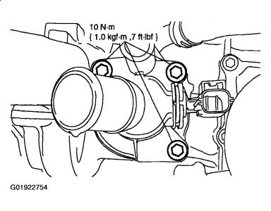

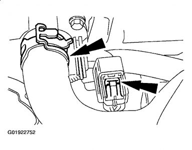

I suspect the thermostat is no working correctly as the water temperature is never hot. The temp gauge reads cool- just on the gauge above the 'C' mark. Where can I find the thermostate, and can I change it easily. I have a good working knowledge of how to repair engines.
Oct 8, 2009 at 6:04 AM
DOCFIXIT
  • 18,828 POSTS
Drain coolant remove electric connector then lower hose then three bolts of housing
