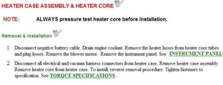

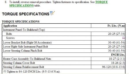

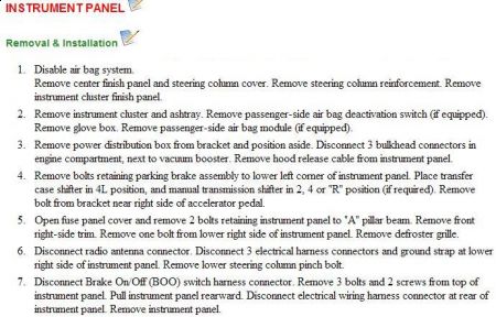

How do you remove a heating coil and reinstall
