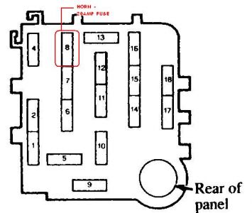

Ei bluelightnin6, it's up and running now. It's only a discharge battery. Found out that the previous charging was only for half day. That's why it went out after a week of not using it, but now it's good to go. This time have a prob. with the fuse, can't locate the fuse for the horn. I look at the fuse box under the steering Wheel but there's no horn indicator on it, only defog, engine, stop, hazard... etc. You know where to locate the fuse for the horn? Thanks.
Jan 29, 2009 at 12:53 PM
BLUELIGHTNIN6
  • 16,542 POSTS
Sure, should be as labeled below.
https://images.2carpros.com/forum/automotive_pictures/261618_Noname_196.jpg
