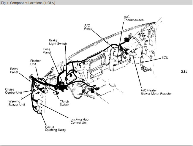

Where under the dash is the fuel pump control relay located?
May 29, 2008 at 1:54 PM
MHPAUTOS
  • 31,937 POSTS
Hi there,

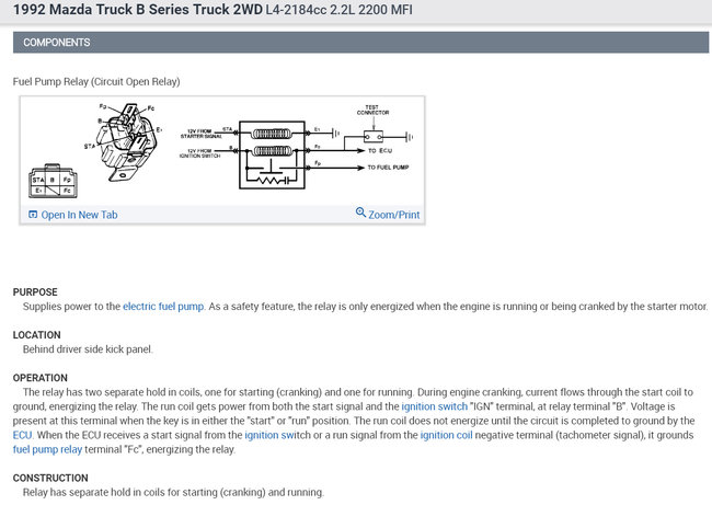

The fuel pump relay is called a circuit open relay.
Circuit Opening Relay (PFI) Behind left kick panel.
Here is a guide to help test it:
Cheers

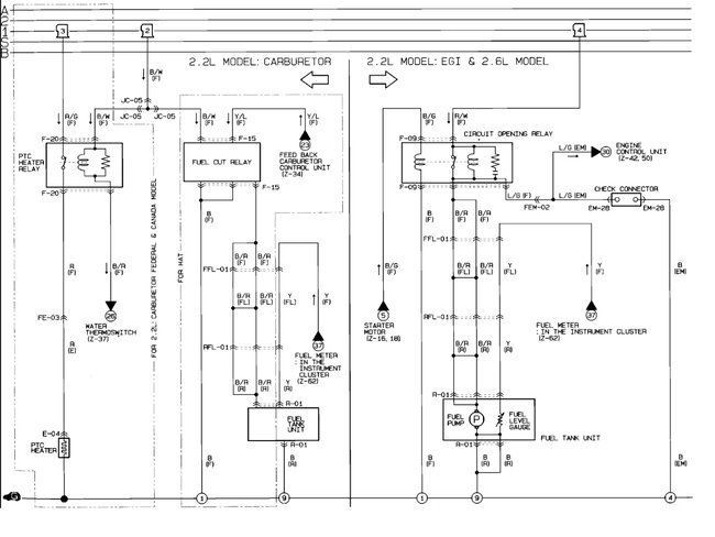

I have a fuel pump in the tank but it is only getting 3.5 volts. We looked behind driver kick panel for a relay however we cannot locate it. is there another place for an electrical problem? The fuel pump is new. If we hook it directly to the battery it works fine, but not with the existing wiring. Help
Sep 20, 2018 at 10:37 AM (Merged)
  • 75,988 POSTS
Inspect and test the circuit opening relay it powers the fuel pump thru the black and red wire. Here is the location of the relay and the fuel pump wiring diagrams with a guide on how to check the relay:
Cheers
