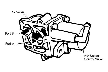

i have a mazda 1992 b2200 with 228000 kms. This started about two weeks ago. It starts ok but idles high. When you give it fuel it wants to die. Let the fuel go and it reves high again. We did a fuel pressure test, a compression test on all cylinders, and a vacuum test and everything is fine. We also changed the fuel filter, air filter, pcv valve and spark plugs. I had it at the garage and the mechanic couldn't find the problem either. Please help.

I would check the idle speed control valve. Simply unplug it and measure the resistance across the terminals on the valve. The resistance should be 7.7 to 9.3 ohms at or near 73 degrees. Here is a pic of the valve. Also clean the the throttle body and throttle plate with throttle body cleaner. Let me know what you find.

I was working on the truck early today for two hours and it was still doing the same thing. I had to clean up my garage as my dad was coming over to get his shocks changed. When I started the truck it ran fine as if there was nothing wrong. I got your responce after this happened could this still be the problem. Right know everything will check out good as it is working. Is there a way to check the high idle or do I have to wait till it screws up again?

I have had the problem again and did what you suggested. Evertning is okay as far as the fast idle speed control sensor is concerned. It is still not running properly. My wife told me to scrap it. I am lost for ideas. Is it time to let it go?

Ok test the coolant temp sensor. Just unplug it and use an ohm meter and ohm the sensor (not the wire harness). If you do this when it is cold then get me the reading and the air temp at the the time of the test. If this tests good then we will check the TPS next.
