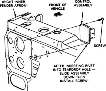

ignition module and location
Nov 11, 2008 at 10:44 AM
BLUELIGHTNIN6
  • 16,542 POSTS
Disconnect the battery cables and remove the battery. Disconnect the electrical connector at the module. Remove the module retaining bolt and remove the module. Position the rivet on the module into the teardrop shaped mounting hole on the fender apron. Push the module into position and secure it with the mounting bolt. Tighten the mounting bolt to 22-31 inch lbs. (2.5-3.5 Nm).
