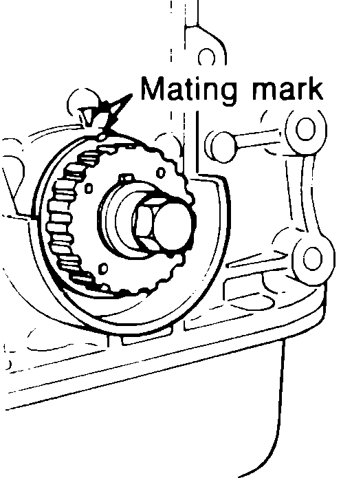

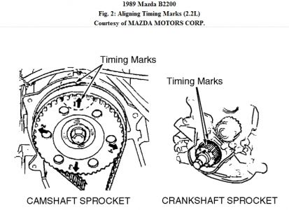

The timing belt slipped on my truck and I was wondering where do I line the top pulley up at, I have the bottom one at 6deg BTDC. Do I line the top pulley up with the number 1 at the arrow or there is a little circle make just before the 1, im not sure if this is where im suposed to line it up at.

What should the cam and crank position be for the timming on a 1986 mazada b2200 can u describe how the cam wheel and crank wheel should be?

Put the engine no.1 piston on its compression stroke/TDC and make sure the rotor is pointing to the no.1 cap tower

Alignment
