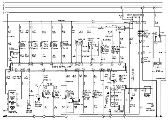

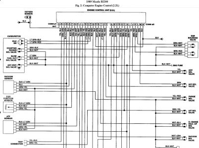

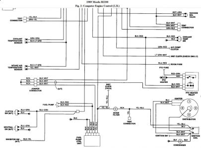

Below I have included all the previous posts related to my problem. It seems to be one thing after another. Truck was running fine with a jumper wire in place to what You called a idle solenoid, but my manual calls an air vent soleniod.Like I was saying, running fine, but was shutting off when it wanted. replaced ignition controller in distrubitor and it now starts when we want it to and shuts off only when we want it to.But now I would like to remove the jumper from the air vent solenoid and have it receive power from the proper source.The continuity of the wire going to the solenoid is good if I jump the plug that goes into the pressure sensor that feeds thhe solenoid it clicks and I found that if I supply power to the black/white stripe wire that I traced it to that goes into the top of the carb it also makes it click.This is as far as I can get with out some help.I would like to follow through on this till the problem is fixed completly. I donated for the first question and was not sure if I was entitled to follow ups on that question or not,so I have donated again. Also, is there any where on line where I can find detailed wiring diagrams for this truck? Thank You in advance and have a good and peaceful day.

Hi Paul, You should have replied to the previous post so that whoever was attending to you can be notified and respond accordingly. Here are the wiring schematic, you might have a fault with the control unit.
https://images.2carpros.com/forum/automotive_pictures/192750_EngineControl89B2200Fig02a_1.jpg
https://images.2carpros.com/forum/automotive_pictures/192750_EngineControl89B2200Fig02b_1.jpg
