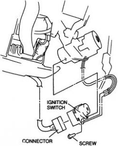

How to change the electrical part of the ignition switch?
Mar 5, 2010 at 5:22 AM
BLUELIGHTNIN6
  • 16,542 POSTS
Disconnect the battery ground cable. Remove the steering column covers. Disconnect the wiring harness connector at the switch. Remove the attaching screw and lift out the switch. Installation is the reverse of removal.
