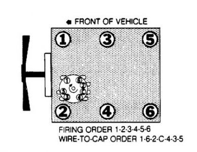

PLEASE EXPLAIN FIRING ORDER MAZDA 929 3.0L
Jun 8, 2010 at 5:11 PM
  • 75,992 POSTS
Firing Order: 1 - 2 - 3 - 4 - 5 - 6
https://images.2carpros.com/forum/automotive_pictures/12900_fo_8.gif
https://www.2carpros.com/kpages/auto_repair_manuals_alldata.htm
Jun 8, 2010 at 5:16 PM
  • 75,992 POSTS
https://images.2carpros.com/forum/automotive_pictures/12900_fom_2.jpg
Jun 8, 2010 at 5:21 PM
ABEL1988
  • 0 POST
not easy to orient. and the seems incorrect.. please verify-for that cylinder location diagram. Also. the dizzy cap has numbers that make that firing order impossible if wired to plugs according to cap numbers.
Nov 6, 2025 at 9:55 AM
  • 54,837 POSTS
Hmm, not to sure what you are saying here? I see the firing order and it looks correct to me.
