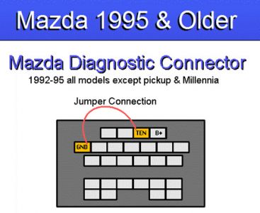

What type of code scanner is to be used on a 94 Mazda 929? Is it an OBD I or OBD II? Any idea where to look for purchasing a relatively inexpensive scanner?

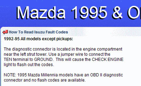

How does a spare piece of wire sound? Follow these instructions!
https://images.2carpros.com/forum/automotive_pictures/62217_Pre96OBD_3.jpg
https://images.2carpros.com/forum/automotive_pictures/62217_Pre96OBDCodess_3.jpg

I did what you said and the engine light flashed twice then three times. How do I find out what that code means?

DTC 23= right side oxygen sensor.
