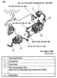

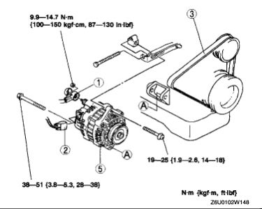

do you have to raise the engine to remove the altinator ?
Aug 8, 2010 at 11:52 AM
  • 75,992 POSTS
Follow procedure below: GENERATOR REMOVAL/INSTALLATION WARNING: When the battery cables are connected, touching the vehicle body with generator terminal B will generate sparks. This can cause personal injury, fire, and damage to the electrical components. Always disconnect the battery before performing the following operation. 1.Disconnect the negative battery cable. 2.Remove the transverse member. (FS) 3.Remove the front pipe. (FS) FS
https://images.2carpros.com/forum/automotive_pictures/12900_a1_19.jpg
KL
https://images.2carpros.com/forum/automotive_pictures/12900_a2_18.jpg
4.Remove in the order indicated in the table. 5.Install in the reverse order of removal. 6.Verify the drive belt deflection/tension. A/C Compressor [KL] Removal Note: Remove the A/C compressor with the pipe still connected. Position the A/C compressor so that it is out of the way. https://www.2carpros.com/kpages/auto_repair_manuals_alldata.htm
