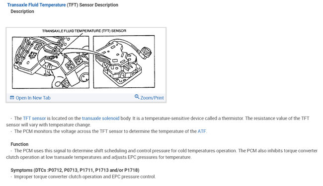

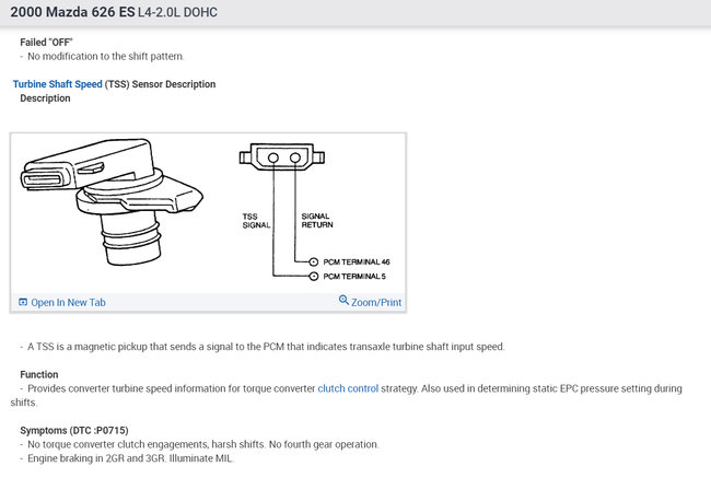

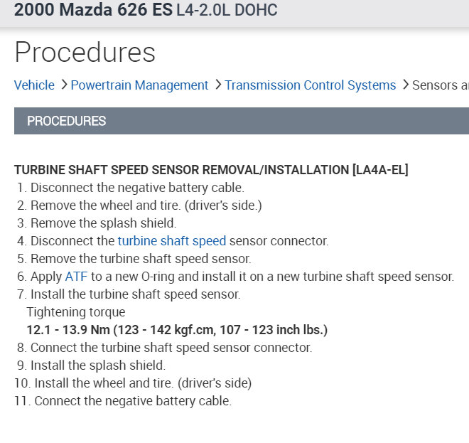

The car wont go into gear in drive, unless i turn overdrive off. if i put the shifter in 1 or 2 it will engage. now with overdrive off, it will shift 1, 2, 3. and if i going around 30+ mph and turn the overdrive on, it will shift into overdrive and run fine until i come to a stop. i cannot find any information on this. any ideas? i checked the TCM for codes. only had p0733. i checked the fluid and the level is good. i tried starting the car in every gear to check the range sensor. and it only started in p or n. i know a transmission guy will know right away. lol

It sounds like it cold be a turbine shaft speed sensor that is not working correctly.here are diagrams and instructions below to help get the problem fixed. Check out the diagrams (below). Please let us know what you find. We are interested to see what it is.
