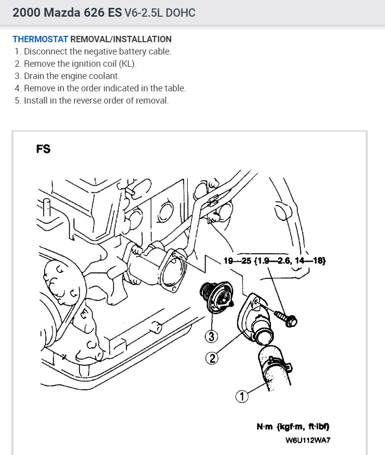

The car is overheating and we think it is the thermostat. do you know where it is? the upper radiator hose looks like it goes right into the intake and the lower one goes up into the engine under the coil pack

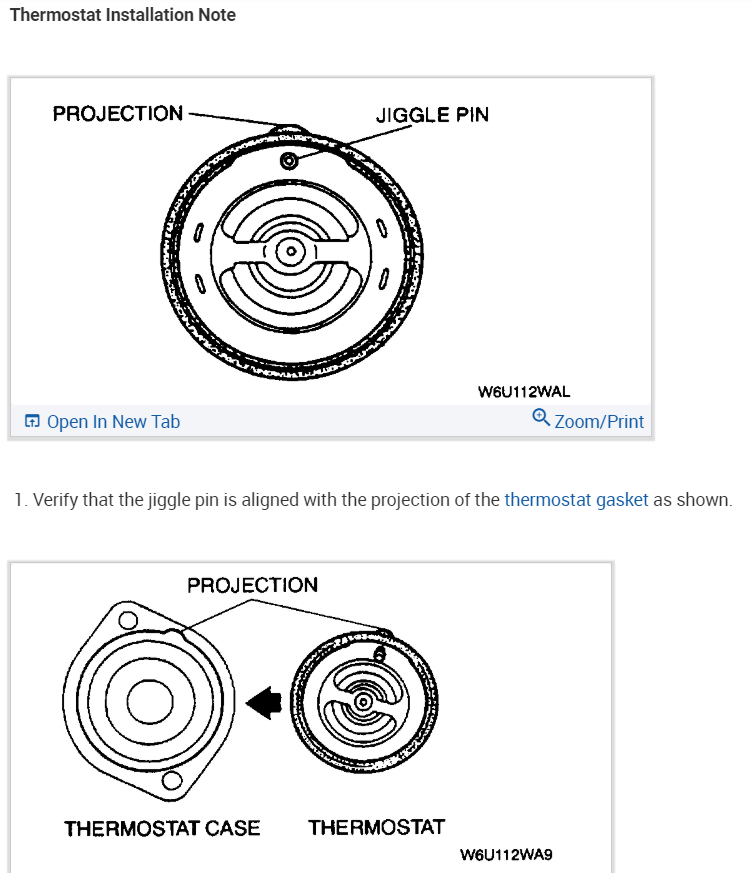

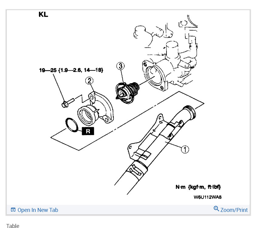

It's in lower radiator hose..you will have to remove the coil to gain access. Here is a guide that will walk your through the repair with diagrams below to show you how on your car.

If you follow the upper radiator hose to the engine, it should lead you to the thermostat housing. If it doesn't, let me know what engine you have.

Follow the radiator bottom hose to the engine-You have to remove the aircleaner to get to it
