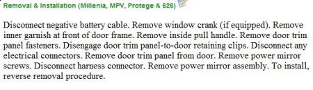

I Damaged the drivers side view mirror on my car and I have a second parts car that i can remove one from and take it to auto body to save money. I need to know how to take the mirror off because i cant get the car to a shop to be removed and what tools i will need.

Just basic tools. If you have manual window, you will need window crank tool, available at your local parts store.
https://images.2carpros.com/forum/automotive_pictures/55316_00626mirror_1.jpg
