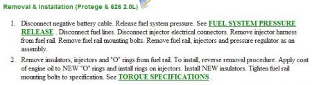

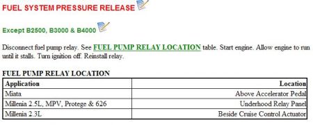

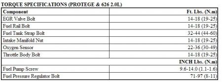

How to replace the fuel injectors on my mazda 626 2.0 l eng.
