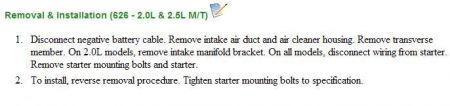

I need to replace the starter in the car.

https://images.2carpros.com/forum/automotive_pictures/261618_Noname_1174.jpg
