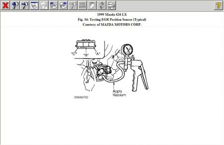

My car has been at the auto repair going on the second day. I've just been told the mechanic is still poking around trying to figure out what's wrong. Can you shed some light on this problem?
Greatly appreciated. Thanks.
Mar 29, 2008 at 5:35 AM
  • 75,992 POSTS

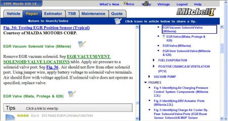

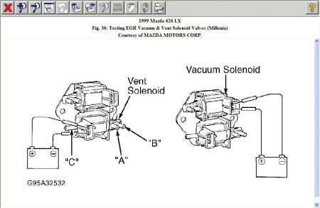

EGR might be carboned or its not getting vacuum thru the vacuum solenoids-up see below
