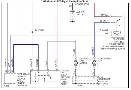

I recently took my car to a machanic to check the cooling fan and aircondition fan to see why they were not working and the car was overheating. He called me and informed me that he had check fan by by-passing the relays and the fan were operational. He concluded that it must be a computer problem or grounding problem but he could not locate the exact cause. I had the transmission rebuilt on the car about a mouth ago. He explain to me that it may be a gorund that runs to the transmission block. My questions is, what can be causing the the fans no to be properly grounded or could their be a computer problem, which I wasn't aware of any thpe computer boards in my car. Nelp fast!

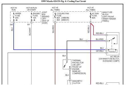

Hi call2preach, Thank you for the donation. The cooling fan relays are controlled by the Power Control Module ( computer). Is the Check Engine Light showing? If you are able to retrieve the code, it would allow us to go into diagnostics to verify the source. Here are the cooling fan circuit.

At PCM connector terminals # 17 ( Gray Wire) and # 45, use test lamp to ground them and check if fans comes on. If yes, the PCM is faulty. If fans does not come on, remove fan relays and with ignition switch ON, there should be 2 terminals with battery voltage.
