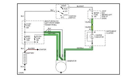

We have a 1999 Mazda 626 1.8 16v.
Our problem is that the battery/charging light will come on intermittantly.t may stay on for a while,then just extinguish..
It comes on with the other ignition lights as normal and goes off when started,but then can come on anytime,there is no pattern to it..
When the light is illuminated,the battery still charges fine(have had this checked,14.1v)..
Anyone have any idea's?? Is there a charge relay that could be causing the problem??
Any help appreciated

Get the alternator/battery load tested-regulator could be failing /also check the wiring harness/belt tension-

If the voltage regulator in the alternator was failing,wouldnt the charge voltage drop too when the light was illuminated ??

The voltage will drop if the regulator is malfunctioning-Load test the battery it might not be taking the charge-

As said,the voltage does not drop when the light is on,it stays at 14.1v at idle.This reading was taken from the rear of the alternator.The battery is new too,so i know that is ok..
The car shows no sign of battery depleation..It always starts and has never broken down,just the charge light intermittantly illuminates???

When the charge light comes On the regulator is not controlling the field windings Or the alternator itself- Do a regulator bypass test this will tell you something between the regulator and alternator. Check the fuse and also wire to wire from and to the alternator. See charging wiring schematic-EWD

Is there anyway that the EWD can be exploded a little???
I cannot see the enough detail on there that i need.
