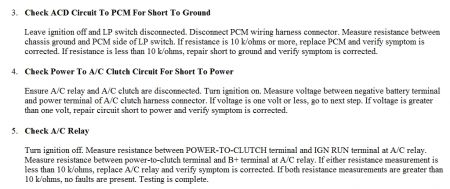

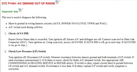

I have a 1999 Mazda 626 with 179000 miles I have recently replaced the EGR valve and up stream oxygen sensor; ever since the replacement of these parts my check engine light has turned on with an error code p1464 "A/C Demand Out Of Self-Test Range" does anyone know what has happen or how can I fix this issue.
