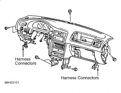

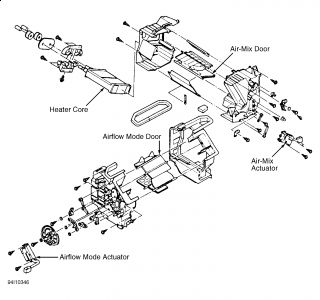

My sons 626 had anti-freeze pour out of the floor hearter duct on the passenger side. We've pulled the dash facing, but are at a loss to see out we remove the heater coil to replace it.
I've looped the cooling sys. hoses so he can still use the car until we can repair it. Any help you can give would be great. Stuck in Houston.
Thanks.
Jan 11, 2010 at 6:58 AM
DOCFIXIT
  • 18,828 POSTS
Entire dash must be removed plus steering collum needs removal "A" pilliar covers see diagrams
