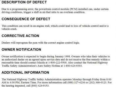

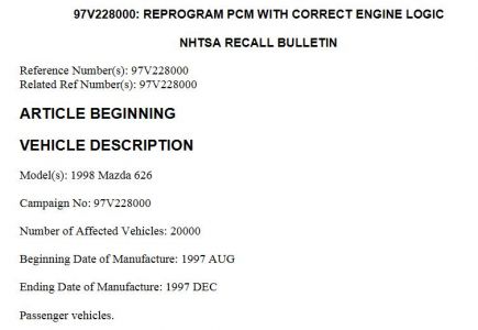

Don't worry, we are not finished till we have exhausted our means of solving the problem. I found a recall for PCM reprogramming and do not know if it is applicable for your model. Maybe you can try calling your local Mazda dealer for some info.
https://images.2carpros.com/forum/automotive_pictures/192750_Recall98Mazda626PCM01_1.jpg
https://images.2carpros.com/forum/automotive_pictures/192750_Recall98Mazda626PCM02_1.jpg
The symptoms described is similar to what you are experiencing. If it is not caused by the PCM, we should not rule out the possibility of an alternator fault. It could be defects with the design of the alternator and could affect quite a number of them. I just concluded some diagnostics with a customer who owns a Nissan and he replaced a few alternators all of which gave him similar problem. Finally he agreed that it is a fault with the design and circuit of the alternator. The alternator was making some noise as well.

By looking at the recall, I don't believe it it applicable to my car, since it has been manufactured in july 1997 (though it is model year 1998) and European version. There were a tag on the PCM that is has been reprogrammed in December 1999. The mazda dealer (importer company) said that the PCM (Ford EEC-V) can not be reprogrammed, but they had the information also on their computer (didn't tell why reprogramming was done). They couldn't explain that.
A year ago,, before the car started to burn oil with the old engine, everything worked fine. I could live with the alternator noise, but the other faults not. For example the smell coming inside the car sometimes gives me headache and the fact that it's impossible to change gears smoothly makes driving in the city hellish.
I also yet haven't found a common factor for the reasons when the car works OK. (driving without electrical load and fast acceleration). After a fast acceleration car can work fine for several days. Couldn't be anything but something clogged?
