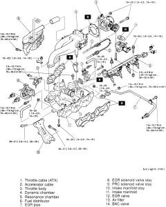

1998 Mazda 626 EGR VALVE
127,500 MILES • 4 CYL • 4WD • AUTOMATIC
WRIVERA01
where is the egr valve located ?
Nov 15, 2008 at 6:53 AM
BLUELIGHTNIN6
  • 16,542 POSTS
Egr valve is located on the back, right side toward the bottom of the engine. It is located in a very hard area to get to between the engine and the firewall. If you take out the intake system and the throttle control you can see it more clearly. There are two coolant lines connected to it. Hope this helped.
