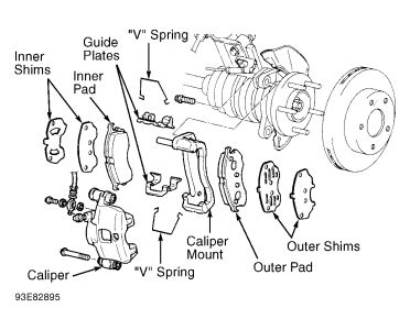

Brakes problem
1998 Mazda 626 4 cyl Two Wheel Drive Automatic
I NEED TO KNOW HOW I AM GOING TO CHANGE THE BRAKES. ON THE CALIPER, THEY HAVE BOLTS ON THE BOTTOM BUT AT THE TOP IS ENCASED IN METAL. I NEVER SEEN THESE TYPES OF CALIPERS. PLEASE HELP!!

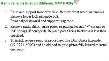

https://images.2carpros.com/forum/automotive_pictures/307763_Noname_12.jpg
https://images.2carpros.com/forum/automotive_pictures/307763_Graphic_2.jpg

OK, I AM TRYING TO UNDERSTAND THE PICTURE..BUT I CAN'T UNDERSTAND HOW TO GET THE CALIPER OFF.

okay are you working on the front or rear brake calipers?

FRONT. EVERYONE SAY'S IT'S SUPPOSED TO SWING UPWARD AFTER REMOVING THE BOTTOM BOLT..BUT IT FEELS LIKE IT'S GETTING STUCK ON SOMETHING. I HAVE CHANGED PLENTY OF BRAKE PADS BUT NEVER HAD A PROBLEM LIKE THIS.

yes there were 2 designs made, one caliper had only 1 mounting bolt, located on lower part of caliper that you remove then pivot caliper upward. the other was the more standard 2 bolt caliper..i'm assuming you have the 1 bolt style so it must just be hitting something if you removed the 1 lower bolt and tried pivoting upward.

yes. it's the one bolt! is there supposed to be anything locking it down?..or is it supposed to be free pivoting?..thank you for the prompt responds

nope, just remove the allen bolt then rotate the caliper upward. maybe your pads were really worn so you might try pushing the caliper piston in with a pry bar then rotating the caliper upward.
