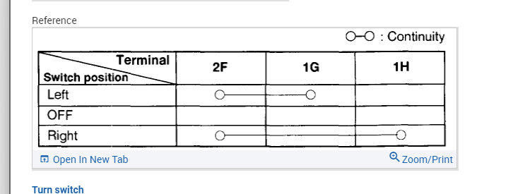

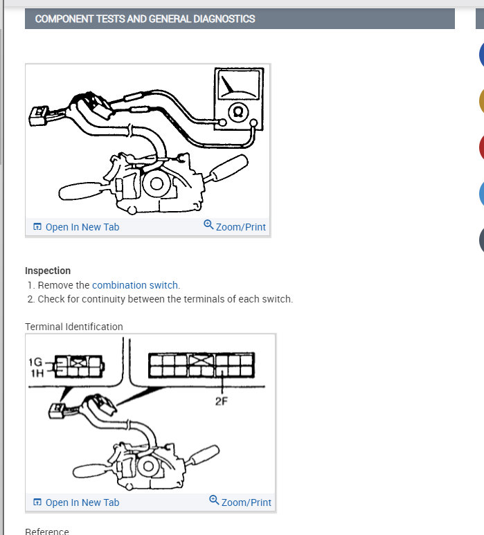

hello, i have the car listed above LX model. my problem, the dash lights, taillights, parking lights, and license plate lights are out. Head lights and blinkers still work, and the fuse is good. what could my problem be?
Thank you,
Mark
Jan 8, 2008 at 7:00 AM

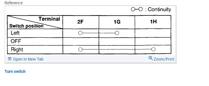

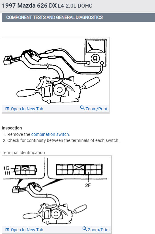

This sounds like a combination switch issue. I am attaching the info below on how to test this to be sure that is what the issue is.
Also, here are some guides that will help with this.
Please let us know what you find with this and we can go from there.
Thanks
Jan 14, 2008 at 6:39 AM
TRUDYNINER
Hello, thanks. I have fixed my problem, it was the combination switch behind the steering wheel, it was $45.00, and it took about 30-45 minutes to fix. Thanks

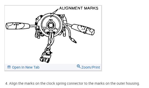

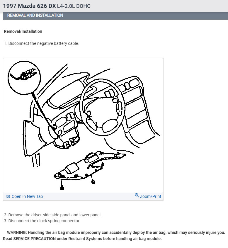

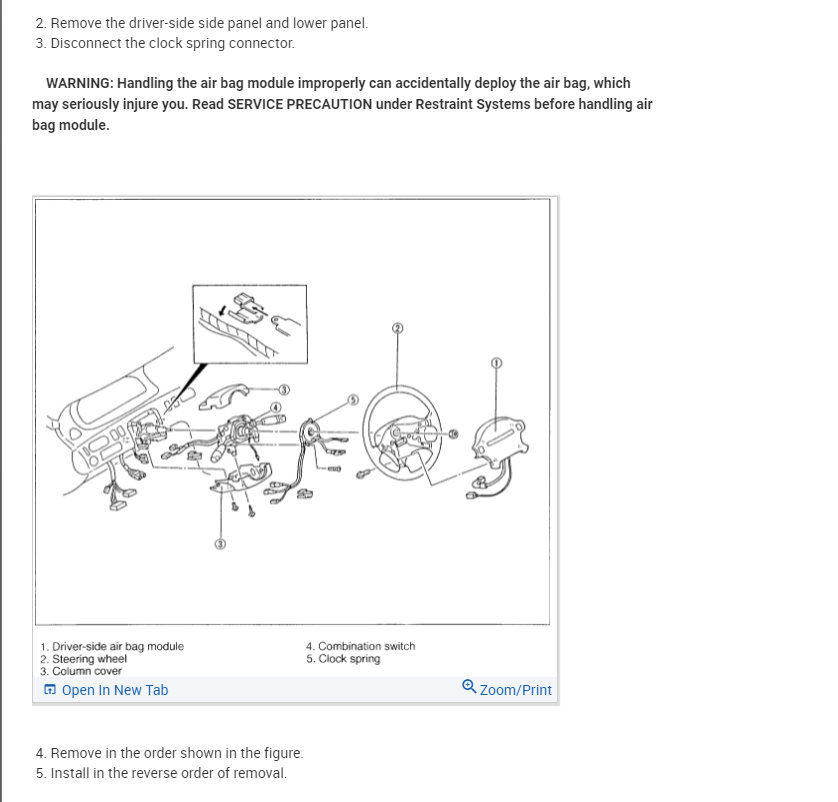

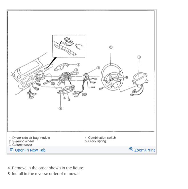

AMBER NICOLE ABSHIRE

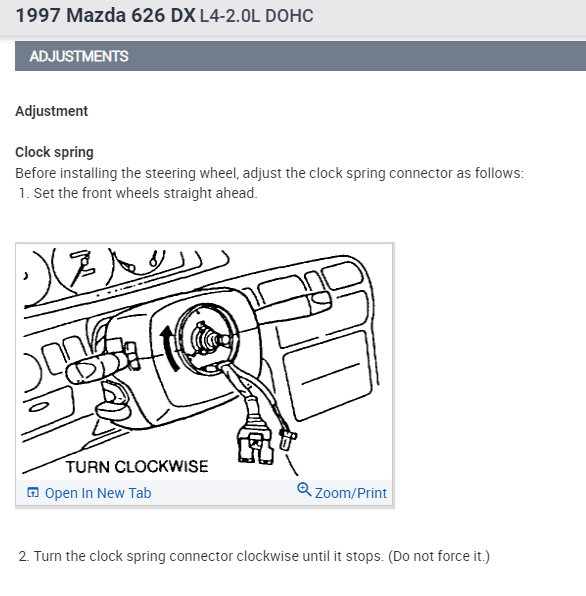

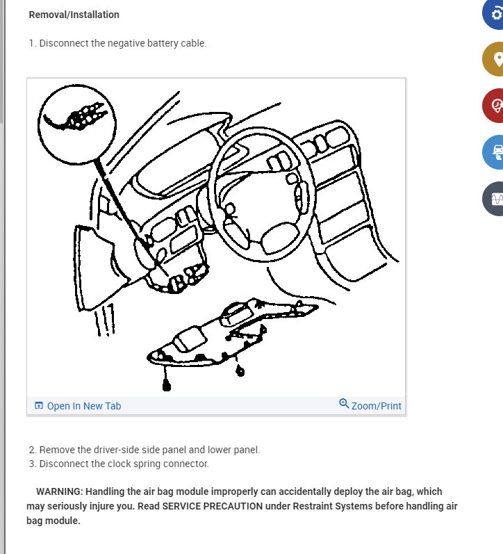

Well, how did you change it? because mine is doing the same thing and I have a switch but instead of replacing it they argue it's not the switch.
Nov 8, 2021 at 1:53 PM
SQM
  • 6,383 POSTS
In order to replace the turn signal switch / combination switch, the steering wheel needs to be removed.
https://www.2carpros.com/articles/steering-wheel-removal
I have attached diagrams below.
