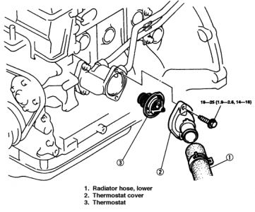

my car is over heating. i looked at a sight and it said that my coolant flange may need to be replaced. i have looked for it on line and cant find it. where is it located?
Jun 28, 2010 at 2:06 PM
  • 75,988 POSTS
Test or replace the thermostat
https://images.2carpros.com/forum/automotive_pictures/12900_stat_6.jpg

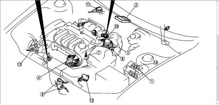

i have already done that. i am looking for something that has a small sensor on top.
Jun 29, 2010 at 3:25 AM
  • 75,988 POSTS
You are probably talking about the coolant temperature sensor which is located at no. 7 , see below
https://images.2carpros.com/forum/automotive_pictures/12900_cts_47.jpg

going to check that out. but the thing is when i drive the car it over heats but leaks only a tinny bit out the resouvor but when its cooled down i have to ad more antifreeze.
