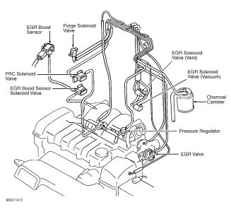

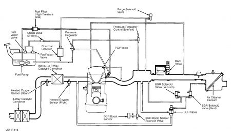

My son has a 1997 Mazda 626 and there is a hose that has come unplugged. We are not sure where it goes and are looking for some sort of diagram to troubleshoot where it belongs. He does have the EGR code showing. We are hoping this lose hose has something to do with it.
Does anyone know where I could find an online diagram?

2.0L vacuum diagrams below
https://images.2carpros.com/forum/automotive_pictures/261618_Graphic_631.jpg
https://images.2carpros.com/forum/automotive_pictures/261618_Graphic2_88.jpg
