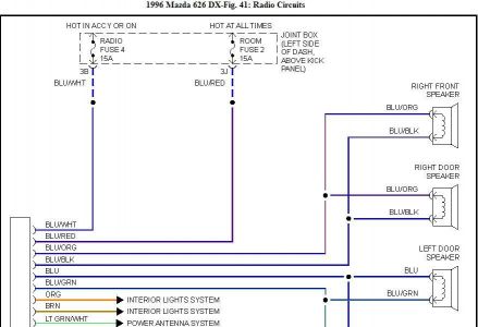

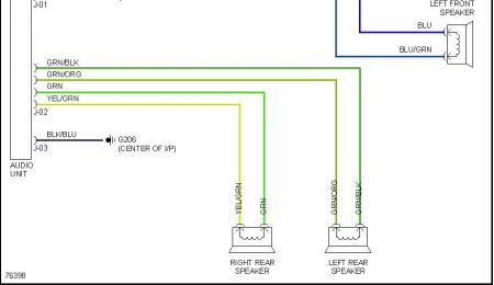

Where would I find a radio wiring diagram? I think I found the color code diagram but i keep getting directed to the 1995. Question 1- are the 96 and 95 the same? Question 2-where might I find a radio wiring diagram?

https://images.2carpros.com/forum/automotive_pictures/261618_Noname_1668.jpg
https://images.2carpros.com/forum/automotive_pictures/261618_Noname2_520.jpg
