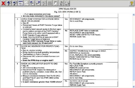

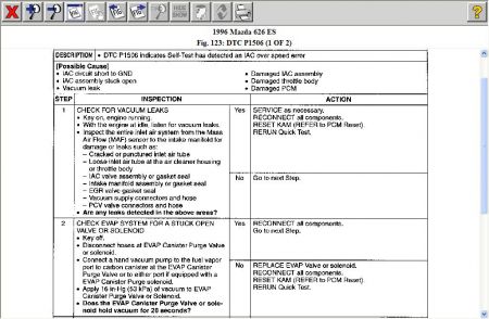

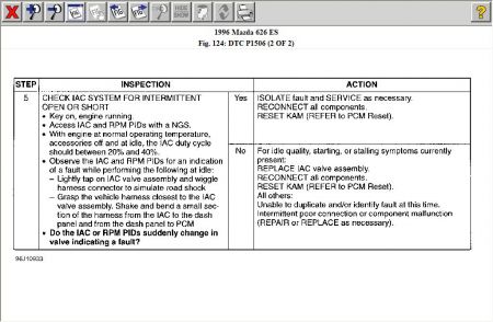

Hi jiggin23, Thank you for the donation. P0141 = Downstream HO2S Heater CKT Malfunction. This is not an O2 problem but the heated circuit and it should not be related to the catalytic converter. Either the HO2S sensor or its wiring circuit is faulty. P0136 = Downstream HO2S CKT Malfunction. This is either due to a fault in the HO2S or the catalytic converter. P0421 = Catalyst efficiency. This is most probably due to a bad catalytic converter but a faulty O2 sensor can cause it, vice versa it can cause a bad O2 reading and indicator malfunction. I have attached a diagnostic for the P1506 and it is self explanatory.
https://images.2carpros.com/forum/automotive_pictures/192750_P1506_96Mazda626a1_1.jpg
https://images.2carpros.com/forum/automotive_pictures/192750_P1506_96Mazda626a2_1.jpg
https://images.2carpros.com/forum/automotive_pictures/192750_P1506_96Mazda626a3_1.jpg
Emission trouble shooting sometimes can be sticky as engine performance can cause it to happen as well. When burning rich or lean, maybe due to vacumn leakages, air flow clogging, fuel pressure low etc can cause it to happen so it would be best to do test and checks first before proceeding with replacement of parts. I believe the catalytic converter is due for replacement.

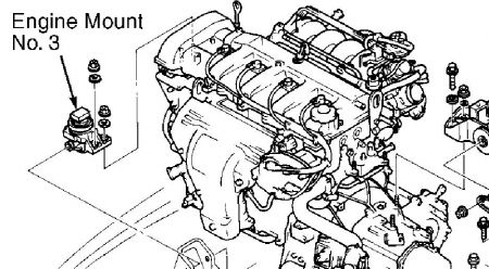

So for an update, I replaced the catalytic converter myself, all went well. still getting codes P0141, P0136 and intermittent P1506. Took it into the same shop, they say that the exhaust manifold needs to be replaced, does this sound like a good diagnosis? Is this something I could replace myself? Thanks for all your help.
Dec 29, 2008 at 12:40 AM
KHLOW2008
  • 41,812 POSTS
Hi jiggin23, To replace the exhaust manifold is not difficult and you should be able to do it yourself. However the bolts and nuts tends to stick so it is best done when the engine is hot and some rust removing spray onto the nuts before removing would be recommended. Exhaust manifolds only needs to be replqaced if they are cracked and would emit noises when engine is running. To perform visual and leakage checking, remove the exhaust shield and look for cracks. Start engine and listen for leaking noise which would normally sould like hollow " put put " and would tend to change pitch when engine is revved slightly. EXHAUST MANIFOLD Removal & Installation Disconnect necessary electrical connectors, hoses and cables. Remove exhaust manifold shield. Disconnect exhaust pipe from exhaust manifold. Remove exhaust manifold bolts and nuts. Remove exhaust manifold. To install, reverse removal procedure. Tighten exhaust manifold bolts to specification.
